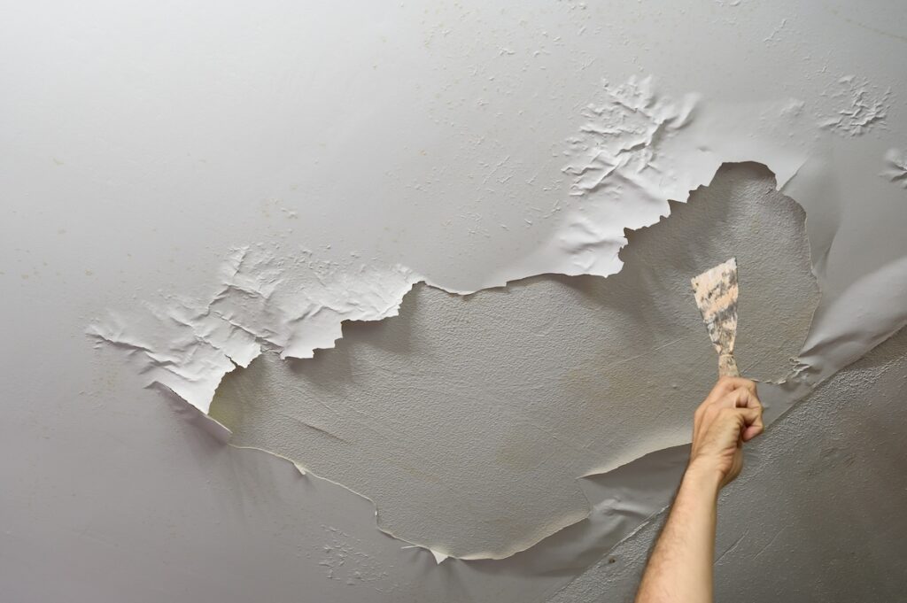

Discovering bubbles under your basement wall paint can be a homeowner’s nightmare, signaling potential underlying issues that demand immediate attention. This article provides a comprehensive guide to understanding the causes of basement wall paint bubbling, effective methods for addressing the problem, and proactive strategies to prevent its recurrence. We aim to equip you with the knowledge and tools necessary to maintain a healthy and visually appealing basement environment. From identifying moisture sources to selecting the right paint and application techniques, this guide covers every aspect of dealing with and preventing basement wall paint bubbling.
Understanding the Root Causes of Basement Wall Paint Bubbling
Basement wall paint bubbling isn’t just a cosmetic issue; it’s a symptom of a larger problem. The most common culprit is moisture. Basements, being below ground level, are naturally prone to dampness. This moisture can originate from several sources, including:
  • Hydrostatic Pressure: Water in the soil surrounding your foundation exerts pressure, forcing moisture through the concrete walls.
  • Capillary Action: Concrete is porous, allowing water to wick up from the ground through capillary action.
  • Condensation: Warm, humid air inside the basement can condense on the cooler concrete walls, especially during the summer months.
  • Leaks: Cracks in the foundation, leaky pipes, or improper drainage can introduce water into the basement.
When moisture penetrates the concrete, it gets trapped behind the paint. As the moisture evaporates, it creates pressure, leading to the formation of bubbles. The type of paint used also plays a role. Non-breathable paints, such as oil-based paints, trap moisture more readily than breathable options like latex paint. Furthermore, improper surface preparation, such as painting over a dirty or damp surface, can exacerbate the problem.
Beyond moisture, other factors can contribute to bubbling. Temperature fluctuations can cause the paint to expand and contract, leading to adhesion issues. In some cases, the bubbling may be due to incompatible paint layers or the application of paint over a poorly primed surface. Identifying the specific cause is crucial for selecting the appropriate solution.
