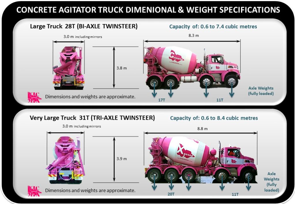

The standard concrete truck, often referred to as a mixer truck or agitator truck, is the workhorse of the concrete delivery industry. In Ireland, these trucks typically have a maximum capacity based on legal weight limits and the truck’s design. Understanding these limits is essential to avoid overloading and potential fines.
A standard concrete truck in Ireland typically carries between 6 to 8 cubic meters (m³) of concrete. This range is influenced by several factors, including:
  • Truck Axle Configuration: Trucks with more axles can legally carry heavier loads.
  • Concrete Density: Different concrete mixes have varying densities, affecting the total weight.
  • Road Regulations: Irish road regulations dictate maximum weight limits for vehicles.
It’s important to note that while a truck can theoretically hold 8 m³, it’s not always advisable or practical to fill it to absolute capacity. Factors like the distance to the delivery site, road conditions, and the specific concrete mix can influence the optimal load size. Overfilling can lead to spillage, reduced maneuverability, and potential damage to the truck.

The density of concrete varies depending on its composition. A mix containing heavy aggregates, like granite or basalt, will be denser than a mix using lighter aggregates. Higher density means each cubic meter weighs more, thus reducing the overall volume a truck can carry without exceeding weight limits. For example, reinforced concrete, which includes steel reinforcement, is heavier than standard concrete.
Truck Axle Configuration and Weight Limits
Irish road regulations impose strict weight limits on vehicles, based on their axle configuration. Trucks with more axles can distribute weight more evenly, allowing for heavier loads. A standard two-axle truck will have a lower weight limit than a four-axle truck. Concrete suppliers must adhere to these regulations to avoid fines and ensure road safety.
