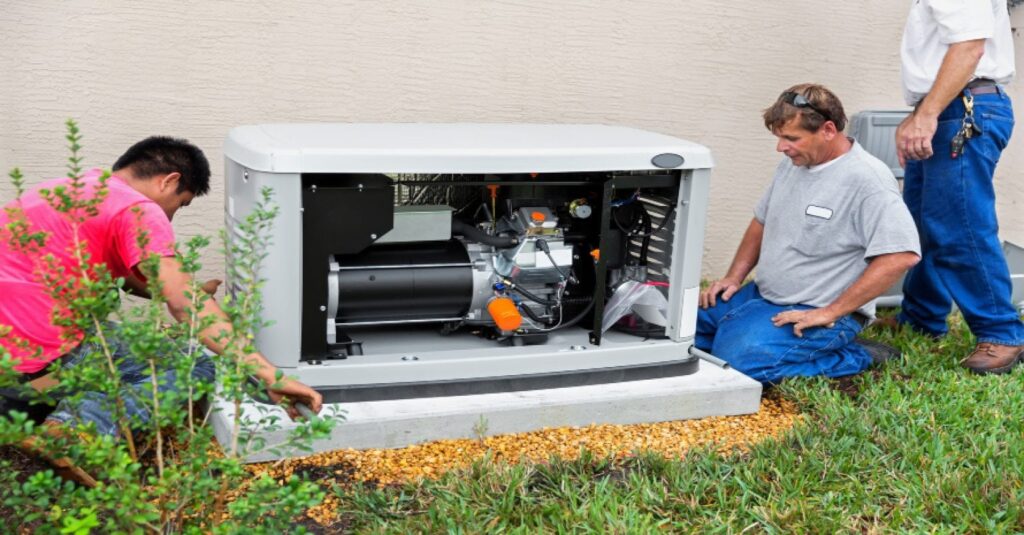

  • Standby Generators: Standby generators are permanently installed and connected to your home’s electrical system. They automatically start when the power goes out and provide backup power until utility power is restored. Standby generators are the most expensive option, but they offer the most convenience and reliability.
