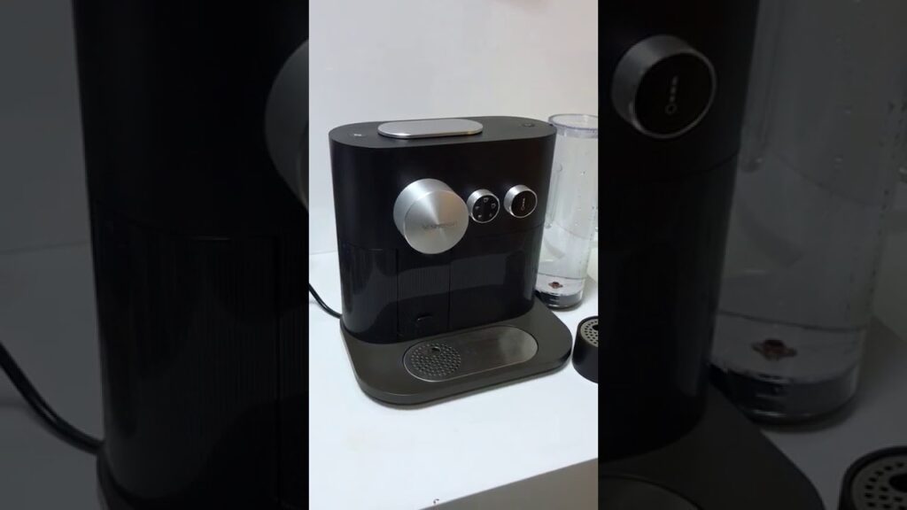

  1. Prepare the Machine:
    • Eject any capsules from the machine.
    • Empty the drip tray and capsule container.
    • Ensure the machine is turned on.
  2. Enter Descaling Mode:
    • Turn the machine off.
    • Press and hold the Lungo button while simultaneously pressing the power button.
    • Release both buttons when the descaling light illuminates. The machine is now in descaling mode.
  3. Prepare the Descaling Solution:
    • Pour one packet of Nespresso descaling solution (or a compatible alternative) into the water tank.
    • Add fresh drinking water to the tank, filling it to the descaling level indicated on the tank.
  4. Start the Descaling Process:
    • Place a container with a minimum capacity of 1 liter under the coffee outlet.
    • Press the Lungo button to start the descaling process. The machine will automatically run the descaling solution through its system.
    • The process takes approximately 20 minutes. The machine will pause intermittently. Do not interrupt the process.
  5. Rinsing Cycle:
    • Once the descaling solution has been used, empty and rinse the water tank thoroughly.
    • Fill the water tank with fresh drinking water to the maximum level.
    • Place the container back under the coffee outlet.
    • Press the Lungo button to start the rinsing cycle. The machine will rinse its system with the fresh water.
    • Repeat the rinsing cycle at least twice to ensure all descaling solution residue is removed.
  6. Exit Descaling Mode:
    • After the final rinsing cycle, the machine will automatically exit descaling mode. The descaling light will turn off.
    • If the machine doesn’t exit descaling mode automatically, turn it off and then on again.
  7. Clean and Reassemble:
    • Empty and clean the drip tray and capsule container.
    • Refill the water tank with fresh drinking water.
    • Reassemble all parts of the machine.
