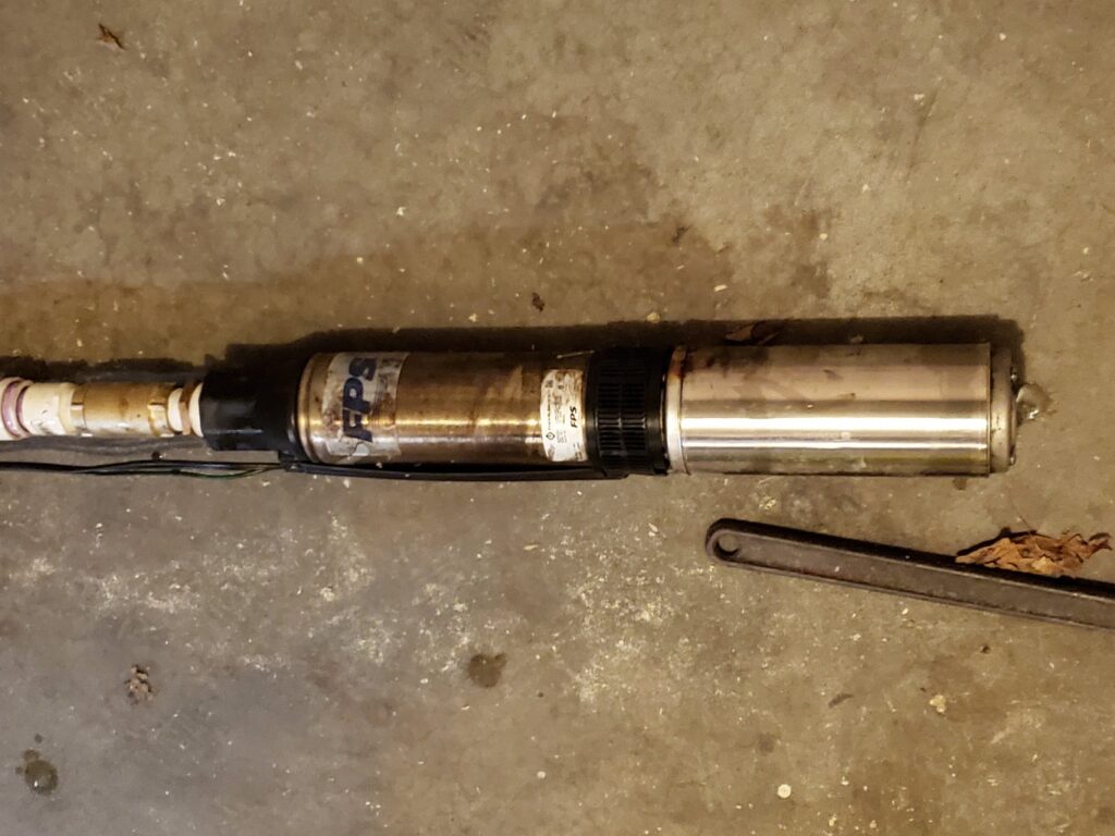

  • Submersible Pump: The entire submersible pump unit is underground and can be affected by direct or indirect strikes.

Listen for the Pump Motor
With the power on (briefly!), listen carefully near the well head or pressure tank. Can you hear the pump motor running? If you hear a humming sound but no water is flowing, the pump motor may be running but unable to pump water due to damage. If you hear no sound at all, the motor may be completely dead.

If You Suspect Damage to the Pump Motor
If you suspect that the pump motor has been damaged by lightning, it’s best to call a well pump technician. Replacing a pump motor can be a complex and time-consuming task, and it requires specialized tools and knowledge. A technician can properly diagnose the problem and recommend the best course of action.

  2. Q: How can I tell if my well pump motor is burned out?
    A: Common signs of a burned-out well pump motor include a complete lack of sound when the pump is supposed to be running, a tripped circuit breaker that won’t reset, a burning smell coming from the control box, or discolored/melted wires within the control box. A multimeter can also be used to test the motor’s windings for continuity.
