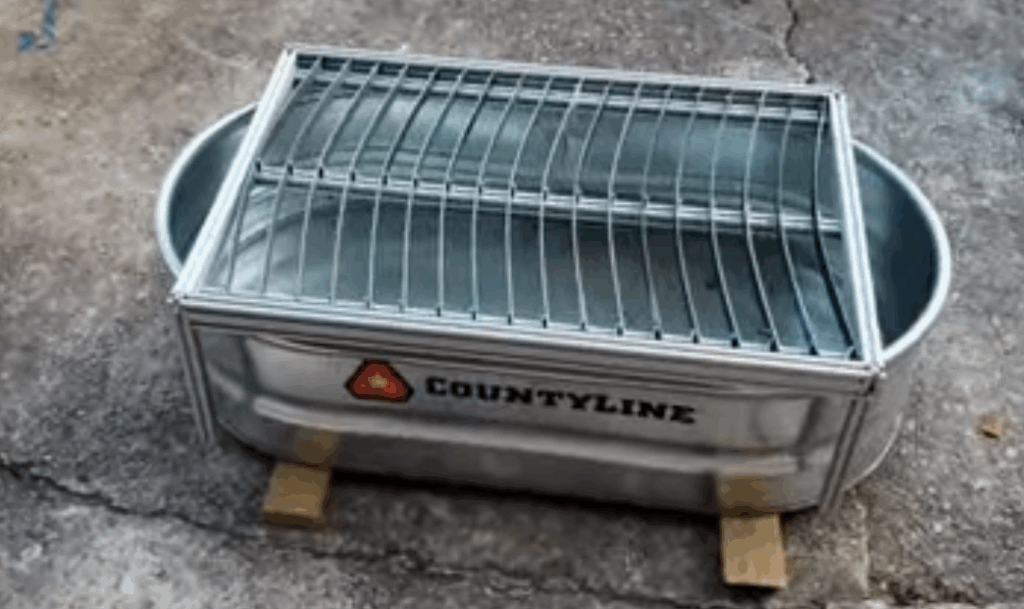

Cutting Surface Options: Slats vs. Water Table
The cutting surface can be constructed using either steel slats or a water table. Steel slats are individual strips of metal that support the workpiece, allowing for easy replacement when damaged. A water table, on the other hand, submerges the workpiece in water, which helps to cool the metal, reduce fumes, and minimize noise. The choice between slats and a water table depends on your specific needs and preferences. Water tables are generally preferred for cutting thinner materials and reducing environmental impact, while slats offer better accessibility for larger or complex parts.

2. Choose Your Cutting Surface: Slats or Water Table
As mentioned earlier, the choice between slats and a water table depends on your specific needs. If you plan to cut thin materials frequently and want to minimize fumes, a water table is a good option. If you need better accessibility for larger parts or prefer a simpler design, slats are a more practical choice.

4. Install the Cutting Surface
Install the cutting surface according to your design. If you’re using steel slats, weld them to the frame, spacing them evenly. If you’re building a water table, construct the water basin and ensure it’s watertight. Consider adding a drain valve for easy water removal.
